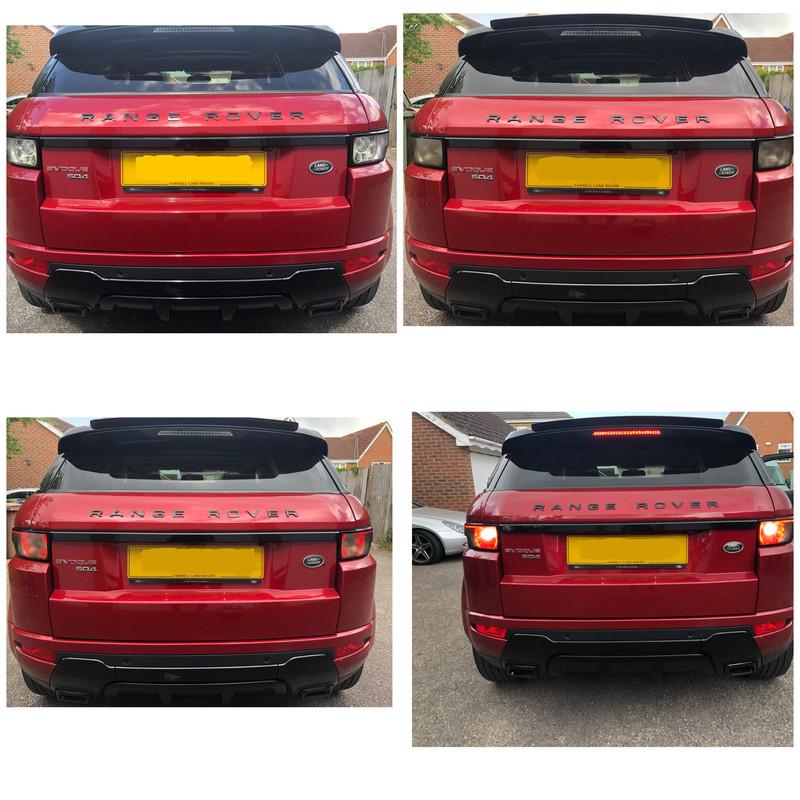

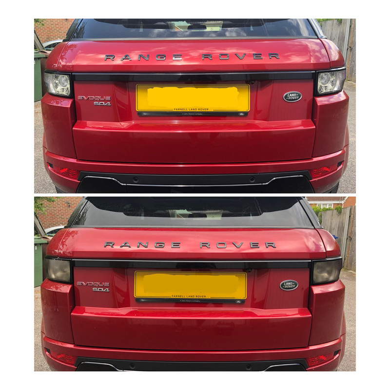

So, reverse LEDs were delivered and ready to be fitted. The rear lights were smoked at the same time to mimic black edition or to match with the front smoked headlights/ fog lights.
Reverse light LEDs:
Before and after smoked effect.
Before, after, with rear lights on and reverse lights on.
Personal observations:
- Happy with reverse LED.
- Smoked tint was kept to one layer as I wanted a minimum/ subtle shade. In real life, lights look better and pictures do not show the real-life presentation.
- Not sure if I should keep it smoked or revert back to OEM state. Open to suggestions here.
PS: Moral policing is welcome. Before someone says that shadow effect reduces the light output, I'd say I agree with you. However, if it was that dangerous then JLR shouldn't be releasing smoked tinted headlights/fog lights and rear black edition tail light.

#5 ·
The led’s are sooo much better 👍 but I think I maybe prefer the non smoke effect lights 🤔

#8 · (Edited)
Thanks all of you for your honest opinions. After applying the smoked tint, I was double-minded as well. Nice clean look vs matt smoked look. I guess I can revert them in 5- 10 minutes.
@Bazz
Didn't realise that we have twin cars. Would be nice to see some photos of your car as well :)
Regarding LEDs, I have done some research and didn't find much difference b/w expensive one (on my beamer and paid £15 for a pair) and this fleabay one (item no: 392573632880). HTH.

#13 ·
facelift smoked lights, look good though and OEM black pack
The facelift tinted rear lamps really freshen up the back end. £250 for the pair though 😲. At least they're plug and play unlike the facelist headlamps.
£250 is not steep for facelift smoked lights. Will check with mrs if she wants them. As she wasn't bothered whether its white or smoked. I wanted to try smoked rear lights to match the front.
Edit: Just realised that they are OOS. Fleabay shows Chinese and German sellers with a price hike.
I like the originals. They just look clean and crisp The smoked ones look faded. Although I don’t dislike them. Personal preference I suppose.
Yup general consensus, keep it nice and clean. I guess I didn't like clear transparent glass on black edition when everything is dark/black and tinted.
Better than sidesteps!
