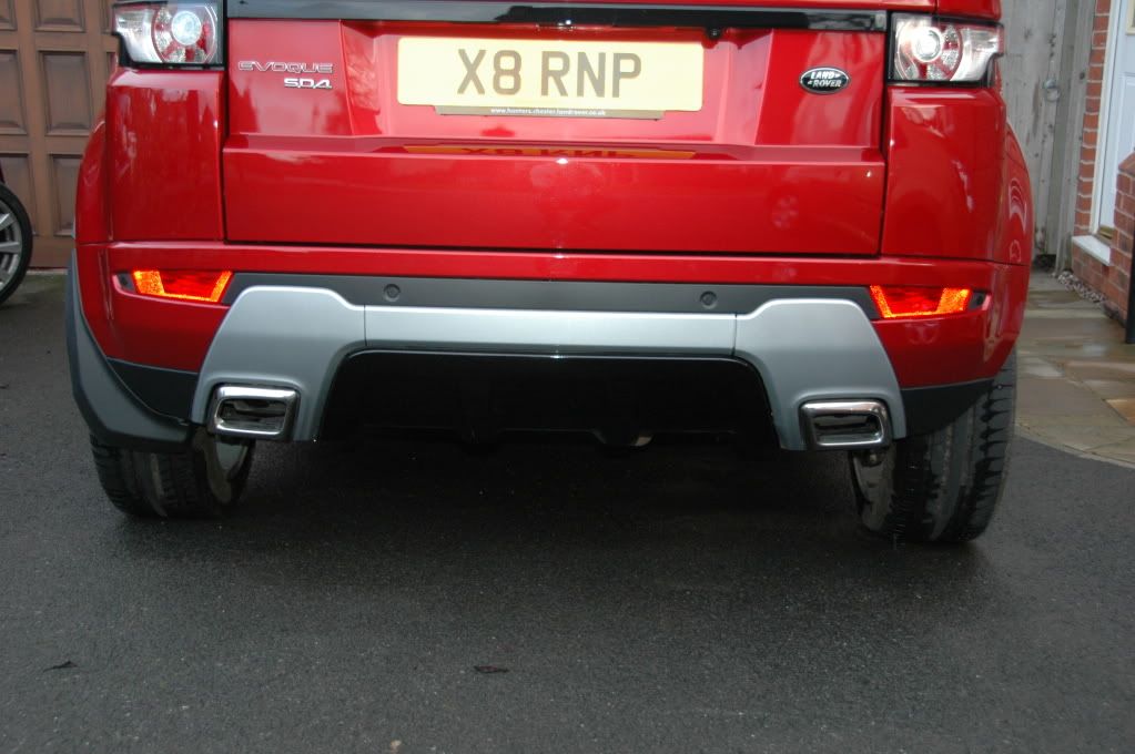

Front fitted, no issues. Rear nearside started but then so did the rain. Still it gives a chance to see the difference. Your choice but, but I know what I prefer.

A picture says more than a thousand words. It doesn't seem to spoil the looks too much. I will give it a go without them first.
edit: I guess it does affect the offroading abilities a little bit.

well done Pete - I know which I prefer - and you will definately notice the difference of a lack of road spray (even with 1 fitted ;-) )
